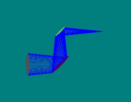

发表于 2004-5-19 02:26:00 | 显示全部楼层
<DIV class=quote><B>以下是引用<I>0079097</I>在2004-5-17 12:40:17的发言:</B>
<P>各位:  ZXMAX中如何设置一个面跟光线成一定的角度?</P>
<P>请详细告之!!  先谢谢啦!</P></DIV>
<img src="data/attachment/forum/dvbbs/2004-5/200451818245968.jpg" border="0" onload="if(this.width>screen.width*0.7) {this.resized=true; this.width=screen.width*0.7; this.alt=\'Click here to open new window\nCTRL+Mouse wheel to zoom in/out\';}" onmouseover="if(this.width>screen.width*0.7) {this.resized=true; this.width=screen.width*0.7; this.style.cursor=\'hand\'; this.alt=\'Click here to open new window\nCTRL+Mouse wheel to zoom in/out\';}" onclick="if(!this.resized) {return true;} else {window.open(\'data/attachment/forum/dvbbs/2004-5/200451818245968.jpg\');}" onmousewheel="return imgzoom(this);" alt="" />
你需要的是这样的吗?用吴博士说的Coordinate-break面型来做吧。
