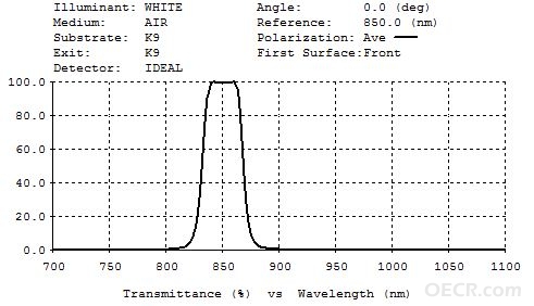

一个850nm滤光片 的常见膜系材料Ti Si 玻璃k9 AOI=0° 中心波长850nm
TIO2A          39.81
SIO2A         122.19
TIO2A          78.80
SIO2A         120.67
TIO2A          77.63
SIO2A         118.58
TIO2A          76.33
SIO2A         117.20
TIO2A          76.15
SIO2A         118.19
TIO2A          77.51
SIO2A         121.05
TIO2A          79.55
SIO2A         124.04
TIO2A          81.16
SIO2A         125.72
TIO2A          81.63
SIO2A         125.50
TIO2A          80.96
SIO2A         123.93
TIO2A          79.85
SIO2A         122.54
TIO2A          79.47
SIO2A         123.13
TIO2A          40.79
SIO2A          85.63
TIO2A         109.05
SIO2A         165.88
TIO2A         106.51
SIO2A         163.45
TIO2A         106.29
SIO2A         165.29
TIO2A         108.58
SIO2A         169.60
TIO2A         111.21
SIO2A         172.54
TIO2A         112.11
SIO2A         172.36
TIO2A         111.15
SIO2A         170.05
TIO2A         109.51
SIO2A         168.06
TIO2A         109.20
SIO2A         170.12
TIO2A         112.53
SIO2A         177.80
TIO2A         117.90
SIO2A         183.50
TIO2A         117.82
SIO2A          90.89
