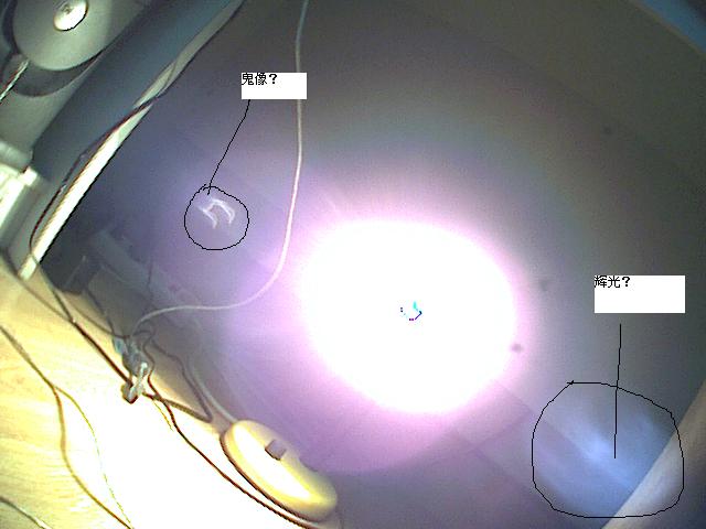

<P>这是我拿到的一颗别家的样品镜头,结构很短,所以现象太明显的说.</P><img src="data/attachment/forum/dvbbs/2004-8/2004897341773.jpg" border="0" onload="if(this.width>screen.width*0.7) {this.resized=true; this.width=screen.width*0.7; this.alt=\'Click here to open new window\nCTRL+Mouse wheel to zoom in/out\';}" onmouseover="if(this.width>screen.width*0.7) {this.resized=true; this.width=screen.width*0.7; this.style.cursor=\'hand\'; this.alt=\'Click here to open new window\nCTRL+Mouse wheel to zoom in/out\';}" onclick="if(!this.resized) {return true;} else {window.open(\'data/attachment/forum/dvbbs/2004-8/2004897341773.jpg\');}" onmousewheel="return imgzoom(this);" alt="" />

高老师:
您好!终于还是您出山了。非常感谢您的指导。这个例子帖上去,就是希望高手能出来讲解讲解。看来您才是“德艺双馨”。
