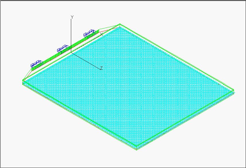

<P><img src="data/attachment/forum/dvbbs/2004-9/200493018514572.jpg" border="0" onload="if(this.width>screen.width*0.7) {this.resized=true; this.width=screen.width*0.7; this.alt=\'Click here to open new window\nCTRL+Mouse wheel to zoom in/out\';}" onmouseover="if(this.width>screen.width*0.7) {this.resized=true; this.width=screen.width*0.7; this.style.cursor=\'hand\'; this.alt=\'Click here to open new window\nCTRL+Mouse wheel to zoom in/out\';}" onclick="if(!this.resized) {return true;} else {window.open(\'data/attachment/forum/dvbbs/2004-9/200493018514572.jpg\');}" onmousewheel="return imgzoom(this);" alt="" />

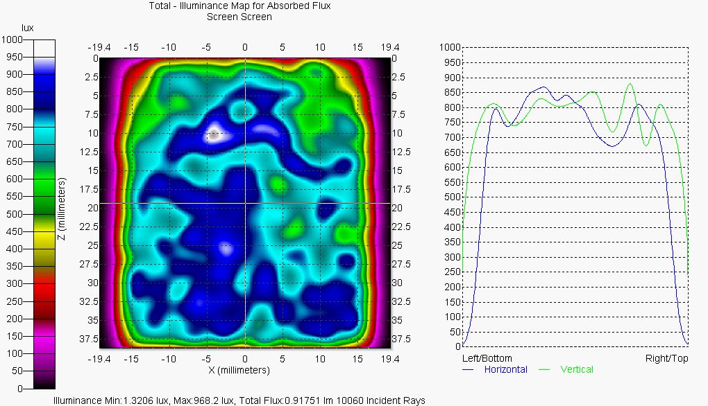

<img src="data/attachment/forum/dvbbs/2004-9/200493018535321.jpg" border="0" onload="if(this.width>screen.width*0.7) {this.resized=true; this.width=screen.width*0.7; this.alt=\'Click here to open new window\nCTRL+Mouse wheel to zoom in/out\';}" onmouseover="if(this.width>screen.width*0.7) {this.resized=true; this.width=screen.width*0.7; this.style.cursor=\'hand\'; this.alt=\'Click here to open new window\nCTRL+Mouse wheel to zoom in/out\';}" onclick="if(!this.resized) {return true;} else {window.open(\'data/attachment/forum/dvbbs/2004-9/200493018535321.jpg\');}" onmousewheel="return imgzoom(this);" alt="" />
只加了Diffuser, 未加BEFI, BEFII和外壳, 设计软件为Tracepro.</P>
一个不太好的背光源设计, 请大家多多指教.

2004-10-7 03:38:00
这个导光板网点排得有点稀,所以亮度低了点。
举报 回复
2004-10-7 05:32:00
<P>是的,网点排的稀,亮度是差了点,但是均匀度就好控制了,因为调节范围大了。</P><P>我觉得我们俩的起步差不多,共同学习!你要的软件我传上去了,什么时候下告诉我一声,我马上就开FTP。下完我就关,因为不想惹麻烦。</P>

2004-10-8 07:32:00
你用了多少光線? 模擬多少時間? 如何得到正確Diffuser 的參數??
举报 回复
2004-10-8 17:29:00
每个LED2万条光线,Diffuser的Haze是80%,模拟时间大概是2个小时。
