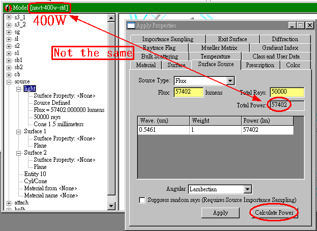

发表于 2004-12-31 04:20:00 | 显示全部楼层 |阅读模式
<P><img src="data/attachment/forum/dvbbs/2004-12/20041230202443156.gif" border="0" onload="if(this.width>screen.width*0.7) {this.resized=true; this.width=screen.width*0.7; this.alt=\'Click here to open new window\nCTRL+Mouse wheel to zoom in/out\';}" onmouseover="if(this.width>screen.width*0.7) {this.resized=true; this.width=screen.width*0.7; this.style.cursor=\'hand\'; this.alt=\'Click here to open new window\nCTRL+Mouse wheel to zoom in/out\';}" onclick="if(!this.resized) {return true;} else {window.open(\'data/attachment/forum/dvbbs/2004-12/20041230202443156.gif\');}" onmousewheel="return imgzoom(this);" alt="" />
</P>
光源可设定辐射的角度吗
光源可设定辐射的角度吗
范例中档案标示的瓦数与软件计算的不同
范例中档案标示的瓦数与软件计算的不同

<P>你設定的flux單位為lumen!</P><P>所以給你計算出的power也是以lumen為單位啦!</P><P>Analysis\Raytrace Options\Radiometric Units改成radiometric</P>
发表于 2004-12-31 17:17:00 | 显示全部楼层
<P>2楼的说的对,是这样的。</P>
