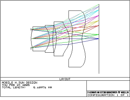

 楼主| 发表于 2005-2-24 16:48:00 | 显示全部楼层
<P>Layout</P>
<img src="data/attachment/forum/dvbbs/2005-2/200522581128769.jpg" border="0" onload="if(this.width>screen.width*0.7) {this.resized=true; this.width=screen.width*0.7; this.alt=\'Click here to open new window\nCTRL+Mouse wheel to zoom in/out\';}" onmouseover="if(this.width>screen.width*0.7) {this.resized=true; this.width=screen.width*0.7; this.style.cursor=\'hand\'; this.alt=\'Click here to open new window\nCTRL+Mouse wheel to zoom in/out\';}" onclick="if(!this.resized) {return true;} else {window.open(\'data/attachment/forum/dvbbs/2005-2/200522581128769.jpg\');}" onmousewheel="return imgzoom(this);" alt="" />

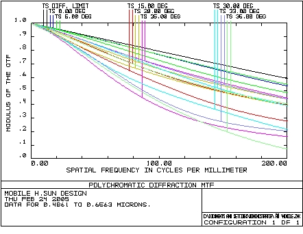

 楼主| 发表于 2005-2-24 16:54:00 | 显示全部楼层
<P>MTF</P><img src="data/attachment/forum/dvbbs/2005-2/200522581227782.jpg" border="0" onload="if(this.width>screen.width*0.7) {this.resized=true; this.width=screen.width*0.7; this.alt=\'Click here to open new window\nCTRL+Mouse wheel to zoom in/out\';}" onmouseover="if(this.width>screen.width*0.7) {this.resized=true; this.width=screen.width*0.7; this.style.cursor=\'hand\'; this.alt=\'Click here to open new window\nCTRL+Mouse wheel to zoom in/out\';}" onclick="if(!this.resized) {return true;} else {window.open(\'data/attachment/forum/dvbbs/2005-2/200522581227782.jpg\');}" onmousewheel="return imgzoom(this);" alt="" />

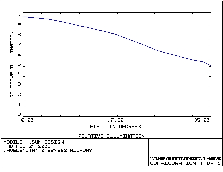

 楼主| 发表于 2005-2-24 16:55:00 | 显示全部楼层
<img src="data/attachment/forum/dvbbs/2005-2/200522581313886.jpg" border="0" onload="if(this.width>screen.width*0.7) {this.resized=true; this.width=screen.width*0.7; this.alt=\'Click here to open new window\nCTRL+Mouse wheel to zoom in/out\';}" onmouseover="if(this.width>screen.width*0.7) {this.resized=true; this.width=screen.width*0.7; this.style.cursor=\'hand\'; this.alt=\'Click here to open new window\nCTRL+Mouse wheel to zoom in/out\';}" onclick="if(!this.resized) {return true;} else {window.open(\'data/attachment/forum/dvbbs/2005-2/200522581313886.jpg\');}" onmousewheel="return imgzoom(this);" alt="" />

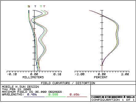

 楼主| 发表于 2005-2-24 16:57:00 | 显示全部楼层
边缘照度有点低了。。。。。
这个是小弟的练习,如果用1G2P的话怎么设计?能达到什么效果,请高手指教。

发表于 2005-2-25 17:12:00 | 显示全部楼层
老大,出射角也忒大了点吧

 楼主| 发表于 2005-2-25 18:47:00 | 显示全部楼层
f=4.2mm 视场角的确是35*2度。。。。
我不是专业设计手机镜头的,这个只是练习,出射角应该控制在多大呢?
我想请教个位老大要用1G2p能做成什么样?
