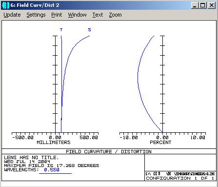

<P>请问,图中左边的ST曲线中,纵坐标表示什么意义啊?</P>
<P>谢谢!</P><img src="data/attachment/forum/dvbbs/2005-2/2005224103726390.jpg" border="0" onload="if(this.width>screen.width*0.7) {this.resized=true; this.width=screen.width*0.7; this.alt=\'Click here to open new window\nCTRL+Mouse wheel to zoom in/out\';}" onmouseover="if(this.width>screen.width*0.7) {this.resized=true; this.width=screen.width*0.7; this.style.cursor=\'hand\'; this.alt=\'Click here to open new window\nCTRL+Mouse wheel to zoom in/out\';}" onclick="if(!this.resized) {return true;} else {window.open(\'data/attachment/forum/dvbbs/2005-2/2005224103726390.jpg\');}" onmousewheel="return imgzoom(this);" alt="" />

<>当然是孔径了!对不?</P>
发表于 2005-2-24 20:13:00 | 显示全部楼层
不是孔径,是视场. 最大坐标表示边缘视场.

是视场,和你的Field中的设置相对应
发表于 2005-4-29 07:09:00 | 显示全部楼层
纵轴是视场,其实就是像高,S,T是子午,弧矢两个方向,叫场曲,它们的差叫像散。光学的初级相差理有。应该去学学,才能把握好设计的技巧。
