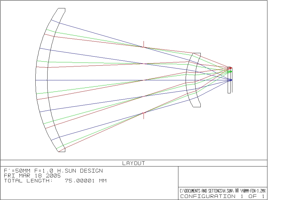

发表于 2005-3-18 17:16:00 | 显示全部楼层
能,今早做了一个,忘了你的角度,,还为相面尺寸奇怪呢,这个5.4度,度数小会更好的。<img src="data/attachment/forum/dvbbs/2005-3/200531891640672.jpg" border="0" onload="if(this.width>screen.width*0.7) {this.resized=true; this.width=screen.width*0.7; this.alt=\'Click here to open new window\nCTRL+Mouse wheel to zoom in/out\';}" onmouseover="if(this.width>screen.width*0.7) {this.resized=true; this.width=screen.width*0.7; this.style.cursor=\'hand\'; this.alt=\'Click here to open new window\nCTRL+Mouse wheel to zoom in/out\';}" onclick="if(!this.resized) {return true;} else {window.open(\'data/attachment/forum/dvbbs/2005-3/200531891640672.jpg\');}" onmousewheel="return imgzoom(this);" alt="" />

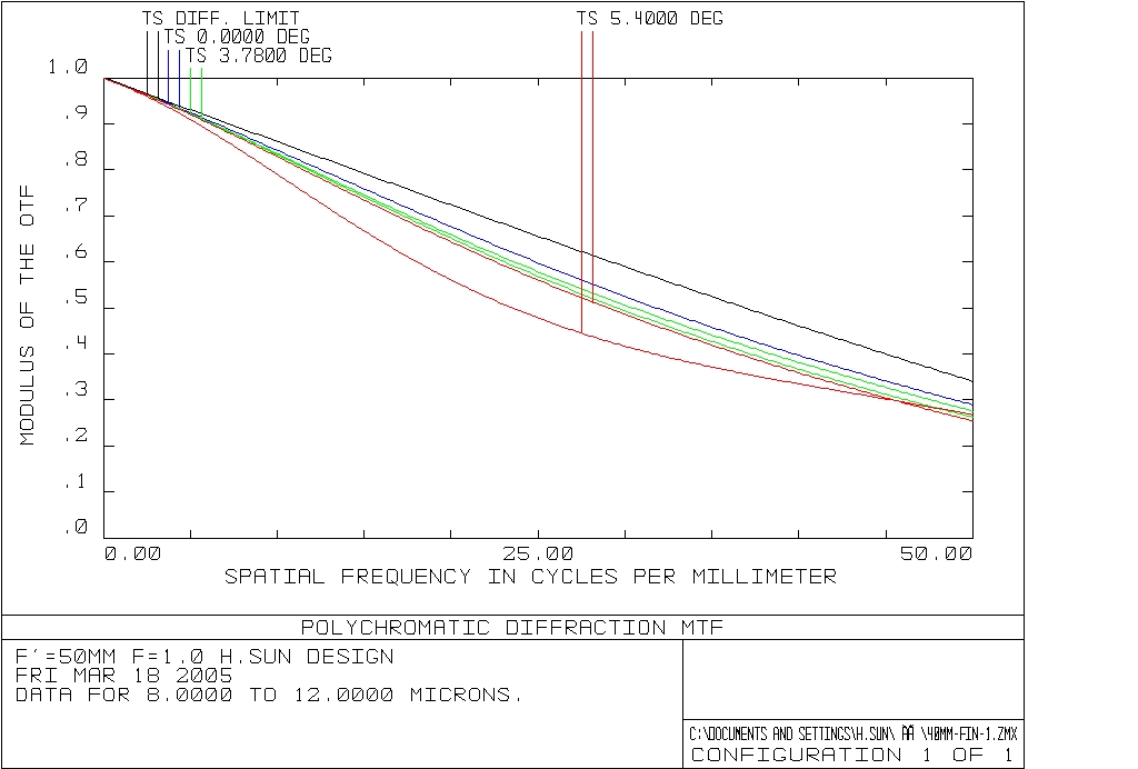

发表于 2005-3-18 17:22:00 | 显示全部楼层
MTF<img src="data/attachment/forum/dvbbs/2005-3/20053189224930.jpg" border="0" onload="if(this.width>screen.width*0.7) {this.resized=true; this.width=screen.width*0.7; this.alt=\'Click here to open new window\nCTRL+Mouse wheel to zoom in/out\';}" onmouseover="if(this.width>screen.width*0.7) {this.resized=true; this.width=screen.width*0.7; this.style.cursor=\'hand\'; this.alt=\'Click here to open new window\nCTRL+Mouse wheel to zoom in/out\';}" onclick="if(!this.resized) {return true;} else {window.open(\'data/attachment/forum/dvbbs/2005-3/20053189224930.jpg\');}" onmousewheel="return imgzoom(this);" alt="" />

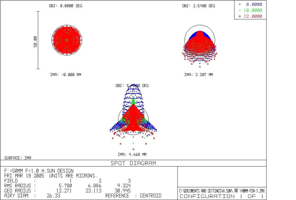

发表于 2005-3-18 17:23:00 | 显示全部楼层
Spot<img src="data/attachment/forum/dvbbs/2005-3/200531892329503.jpg" border="0" onload="if(this.width>screen.width*0.7) {this.resized=true; this.width=screen.width*0.7; this.alt=\'Click here to open new window\nCTRL+Mouse wheel to zoom in/out\';}" onmouseover="if(this.width>screen.width*0.7) {this.resized=true; this.width=screen.width*0.7; this.style.cursor=\'hand\'; this.alt=\'Click here to open new window\nCTRL+Mouse wheel to zoom in/out\';}" onclick="if(!this.resized) {return true;} else {window.open(\'data/attachment/forum/dvbbs/2005-3/200531892329503.jpg\');}" onmousewheel="return imgzoom(this);" alt="" />
 楼主| 发表于 2005-3-18 22:54:00 | 显示全部楼层
孙兄到底还是厉害呀,一个非球面就能做到,小弟佩服。不过你的后截距有多大呀?
 楼主| 发表于 2005-3-19 00:23:00 | 显示全部楼层
还有,探测器前的保护玻璃是怎么设定的呢?望指教!
发表于 2005-3-19 02:58:00 | 显示全部楼层
320x240的都行,,,你这个角度还小,,很简单。
后截距够的放心。。。不过其实你可以不用自己设计,
上次跟你说了加工你不好联系的,没人愿意给你做,
还不如直接在我们这做,机械也可以帮你设计,包括装配。
这么简单的设计又不收你设计费用。
像你这样投入和产出不成比例。
那是锗窗口,要看探测器成像面的位置。
