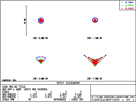

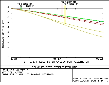

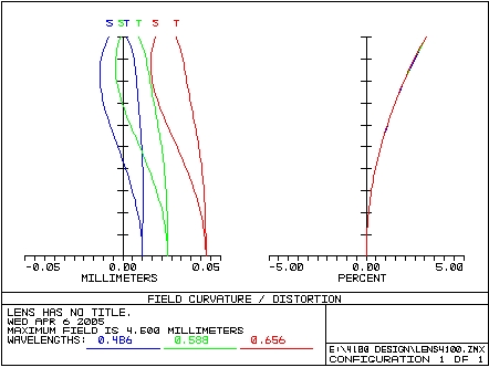

发表于 2005-4-7 03:31:00 | 显示全部楼层 |阅读模式
<img src="data/attachment/forum/dvbbs/2005-4/20054619316718.jpg" border="0" onload="if(this.width>screen.width*0.7) {this.resized=true; this.width=screen.width*0.7; this.alt=\'Click here to open new window\nCTRL+Mouse wheel to zoom in/out\';}" onmouseover="if(this.width>screen.width*0.7) {this.resized=true; this.width=screen.width*0.7; this.style.cursor=\'hand\'; this.alt=\'Click here to open new window\nCTRL+Mouse wheel to zoom in/out\';}" onclick="if(!this.resized) {return true;} else {window.open(\'data/attachment/forum/dvbbs/2005-4/20054619316718.jpg\');}" onmousewheel="return imgzoom(this);" alt="" />
<img src="data/attachment/forum/dvbbs/2005-4/20054619311624.jpg" border="0" onload="if(this.width>screen.width*0.7) {this.resized=true; this.width=screen.width*0.7; this.alt=\'Click here to open new window\nCTRL+Mouse wheel to zoom in/out\';}" onmouseover="if(this.width>screen.width*0.7) {this.resized=true; this.width=screen.width*0.7; this.style.cursor=\'hand\'; this.alt=\'Click here to open new window\nCTRL+Mouse wheel to zoom in/out\';}" onclick="if(!this.resized) {return true;} else {window.open(\'data/attachment/forum/dvbbs/2005-4/20054619311624.jpg\');}" onmousewheel="return imgzoom(this);" alt="" />
<img src="data/attachment/forum/dvbbs/2005-4/200546193128126.jpg" border="0" onload="if(this.width>screen.width*0.7) {this.resized=true; this.width=screen.width*0.7; this.alt=\'Click here to open new window\nCTRL+Mouse wheel to zoom in/out\';}" onmouseover="if(this.width>screen.width*0.7) {this.resized=true; this.width=screen.width*0.7; this.style.cursor=\'hand\'; this.alt=\'Click here to open new window\nCTRL+Mouse wheel to zoom in/out\';}" onclick="if(!this.resized) {return true;} else {window.open(\'data/attachment/forum/dvbbs/2005-4/200546193128126.jpg\');}" onmousewheel="return imgzoom(this);" alt="" />
绝对经典的单焦点数码镜头
绝对经典的单焦点数码镜头
绝对经典的单焦点数码镜头
绝对经典的单焦点数码镜头
绝对经典的单焦点数码镜头
绝对经典的单焦点数码镜头
 楼主| 发表于 2005-4-7 03:38:00 | 显示全部楼层
唯一的遗憾是边缘畸变有3%。
发表于 2005-4-7 21:05:00 | 显示全部楼层
边缘的出射角是多大?从你上个设计来看,太大了。
发表于 2005-4-7 21:40:00 | 显示全部楼层
老大,设计要考虑的东西不仅仅是这些,要考虑的东西多着。
 楼主| 发表于 2005-4-7 23:32:00 | 显示全部楼层
<TABLE 753pt; BORDER-COLLAPSE: collapse" cellSpacing=0 cellPadding=0 width=1002 border=0 x:str><COLGROUP><COL style="WIDTH: 54pt" span=2 width=72><COL style="WIDTH: 74pt; mso-width-source: userset; mso-width-alt: 3168" width=99><COL style="WIDTH: 58pt; mso-width-source: userset; mso-width-alt: 2464" width=77><COL style="WIDTH: 62pt; mso-width-source: userset; mso-width-alt: 2624" width=82><COL style="WIDTH: 54pt" span=3 width=72><COL style="WIDTH: 68pt; mso-width-source: userset; mso-width-alt: 2880" width=90><COL style="WIDTH: 82pt; mso-width-source: userset; mso-width-alt: 3488" width=109><COL style="WIDTH: 54pt" width=72><COL style="WIDTH: 85pt; mso-width-source: userset; mso-width-alt: 3616" width=113><TR 14.25pt" height=19><TD 54pt; HEIGHT: 14.25pt" width=72 height=19>#</TD><TD 54pt" width=72>Type</TD><TD 74pt" width=99>Curvature</TD><TD 58pt" width=77>Thickness</TD><TD 62pt" width=82>Glass</TD><TD 54pt" width=72>Semi-Diameter</TD><TD 54pt" width=72>Conic</TD><TD 54pt" width=72>Parameter 1</TD><TD 68pt" width=90>Parameter 2</TD><TD 82pt" width=109>Parameter 3</TD><TD 54pt" width=72>Parameter 4</TD><TD 85pt" width=113>Parameter 5</TD></TR><TR 15.75pt" height=21><TD 15.75pt" align=right height=21 x:num>0</TD><TD class=xl25>OBJ</TD><TD class=xl24 align=right x:num="0">0.00E+00</TD><TD class=xl24 align=right x:num="1500">1.50E+03</TD><TD></TD><TD class=xl24 align=right x:num="363.06553000000002">3.63E+02</TD><TD class=xl24 align=right x:num="0">0.00E+00</TD><TD class=xl24 align=right x:num="0">0.00E+00</TD><TD class=xl24 align=right x:num="0">0.00E+00</TD><TD class=xl24 align=right x:num="0">0.00E+00</TD><TD class=xl24 align=right x:num="0">0.00E+00</TD><TD class=xl24 align=right x:num="0">0.00E+00</TD></TR><TR 15.75pt" height=21><TD 15.75pt" align=right height=21 x:num>1</TD><TD>STANDARD</TD><TD class=xl24 align=right x:num="9.0995935999999999E-2">9.10E-02</TD><TD class=xl24 align=right x:num="1">1.00E+00</TD><TD class=xl25>1.69,53.9</TD><TD class=xl24 align=right x:num="3.75">3.75E+00</TD><TD class=xl24 align=right x:num="0">0.00E+00</TD><TD class=xl24 align=right x:num="0">0.00E+00</TD><TD class=xl24 align=right x:num="0">0.00E+00</TD><TD class=xl24 align=right x:num="0">0.00E+00</TD><TD class=xl24 align=right x:num="0">0.00E+00</TD><TD class=xl24 align=right x:num="0">0.00E+00</TD></TR><TR 14.25pt" height=19><TD 14.25pt" align=right height=19 x:num>2</TD><TD>STANDARD</TD><TD class=xl24 align=right x:num="1.6909633E-2">1.69E-02</TD><TD class=xl24 align=right x:num="9.9910201000000004E-2">9.99E-02</TD><TD></TD><TD class=xl24 align=right x:num="3.75">3.75E+00</TD><TD class=xl24 align=right x:num="0">0.00E+00</TD><TD class=xl24 align=right x:num="0">0.00E+00</TD><TD class=xl24 align=right x:num="0">0.00E+00</TD><TD class=xl24 align=right x:num="0">0.00E+00</TD><TD class=xl24 align=right x:num="0">0.00E+00</TD><TD class=xl24 align=right x:num="0">0.00E+00</TD></TR><TR 15.75pt" height=21><TD 15.75pt" align=right height=21 x:num>3</TD><TD>STANDARD</TD><TD class=xl24 align=right x:num="0.19393107000000001">1.94E-01</TD><TD class=xl24 align=right x:num="00.9">9.00E-01</TD><TD class=xl25>1.68,55.2</TD><TD class=xl24 align=right x:num="3">3.00E+00</TD><TD class=xl24 align=right x:num="0">0.00E+00</TD><TD class=xl24 align=right x:num="0">0.00E+00</TD><TD class=xl24 align=right x:num="0">0.00E+00</TD><TD class=xl24 align=right x:num="0">0.00E+00</TD><TD class=xl24 align=right x:num="0">0.00E+00</TD><TD class=xl24 align=right x:num="0">0.00E+00</TD></TR><TR 15.75pt" height=21><TD 15.75pt" align=right height=21 x:num>4</TD><TD>STANDARD</TD><TD class=xl24 align=right x:num="3.2330066999999997E-2">3.23E-02</TD><TD class=xl24 align=right x:num="0.68500000000000005">6.85E-01</TD><TD class=xl25>1.69,31.2</TD><TD class=xl24 align=right x:num="3">3.00E+00</TD><TD class=xl24 align=right x:num="0">0.00E+00</TD><TD class=xl24 align=right x:num="0">0.00E+00</TD><TD class=xl24 align=right x:num="0">0.00E+00</TD><TD class=xl24 align=right x:num="0">0.00E+00</TD><TD class=xl24 align=right x:num="0">0.00E+00</TD><TD class=xl24 align=right x:num="0">0.00E+00</TD></TR><TR 14.25pt" height=19><TD 14.25pt" align=right height=19 x:num>5</TD><TD>STANDARD</TD><TD class=xl24 align=right x:num="7.5181499999999998E-2">7.52E-02</TD><TD class=xl24 align=right x:num="0.25">2.50E-01</TD><TD></TD><TD class=xl24 align=right x:num="2.45">2.45E+00</TD><TD class=xl24 align=right x:num="0">0.00E+00</TD><TD class=xl24 align=right x:num="0">0.00E+00</TD><TD class=xl24 align=right x:num="0">0.00E+00</TD><TD class=xl24 align=right x:num="0">0.00E+00</TD><TD class=xl24 align=right x:num="0">0.00E+00</TD><TD class=xl24 align=right x:num="0">0.00E+00</TD></TR><TR 15.75pt" height=21><TD 15.75pt" align=right height=21 x:num>6</TD><TD class=xl25>STO</TD><TD class=xl24 align=right x:num="0">0.00E+00</TD><TD class=xl24 align=right x:num="00.3">3.00E-01</TD><TD></TD><TD class=xl24 align=right x:num="2.4">2.40E+00</TD><TD class=xl24 align=right x:num="0">0.00E+00</TD><TD class=xl24 align=right x:num="0">0.00E+00</TD><TD class=xl24 align=right x:num="0">0.00E+00</TD><TD class=xl24 align=right x:num="0">0.00E+00</TD><TD class=xl24 align=right x:num="0">0.00E+00</TD><TD class=xl24 align=right x:num="0">0.00E+00</TD></TR><TR 15.75pt" height=21><TD 15.75pt" align=right height=21 x:num>7</TD><TD>STANDARD</TD><TD class=xl24 align=right x:num="5.1092483000000001E-2">5.11E-02</TD><TD class=xl24 align=right x:num="0.5">5.00E-01</TD><TD class=xl25>1.69,31.2</TD><TD class=xl24 align=right x:num="2.5">2.50E+00</TD><TD class=xl24 align=right x:num="0">0.00E+00</TD><TD class=xl24 align=right x:num="0">0.00E+00</TD><TD class=xl24 align=right x:num="0">0.00E+00</TD><TD class=xl24 align=right x:num="0">0.00E+00</TD><TD class=xl24 align=right x:num="0">0.00E+00</TD><TD class=xl24 align=right x:num="0">0.00E+00</TD></TR><TR 14.25pt" height=19><TD 14.25pt" align=right height=19 x:num>8</TD><TD>STANDARD</TD><TD class=xl24 align=right x:num="0.26773785999999999">2.68E-01</TD><TD class=xl24 align=right x:num="3.8524875999999999">3.85E+00</TD><TD></TD><TD class=xl24 align=right x:num="2.1749999999999998">2.18E+00</TD><TD class=xl24 align=right x:num="0">0.00E+00</TD><TD class=xl24 align=right x:num="0">0.00E+00</TD><TD class=xl24 align=right x:num="0">0.00E+00</TD><TD class=xl24 align=right x:num="0">0.00E+00</TD><TD class=xl24 align=right x:num="0">0.00E+00</TD><TD class=xl24 align=right x:num="0">0.00E+00</TD></TR><TR 15.75pt" height=21><TD 15.75pt" align=right height=21 x:num>9</TD><TD>STANDARD</TD><TD class=xl24 align=right x:num="-8.6919045E-3">-8.69E-03</TD><TD class=xl24 align=right x:num="0.5">5.00E-01</TD><TD class=xl25>1.59,29.9</TD><TD class=xl24 align=right x:num="3.2">3.20E+00</TD><TD class=xl24 align=right x:num="0">0.00E+00</TD><TD class=xl24 align=right x:num="0">0.00E+00</TD><TD class=xl24 align=right x:num="0">0.00E+00</TD><TD class=xl24 align=right x:num="0">0.00E+00</TD><TD class=xl24 align=right x:num="0">0.00E+00</TD><TD class=xl24 align=right x:num="0">0.00E+00</TD></TR><TR 14.25pt" height=19><TD 14.25pt" align=right height=19 x:num>10</TD><TD>EVENASPH</TD><TD class=xl24 align=right x:num="-5.9939792999999998E-2">-5.99E-02</TD><TD class=xl24 align=right x:num="3.2872937000000002">3.29E+00</TD><TD></TD><TD class=xl24 align=right x:num="3.2">3.20E+00</TD><TD class=xl24 align=right x:num="4.1148344999999997">4.11E+00</TD><TD class=xl24 align=right x:num="0">0.00E+00</TD><TD class=xl24 align=right x:num="1.7469166E-4">1.75E-04</TD><TD class=xl24 align=right x:num="-1.2767548000000001E-5">-1.28E-05</TD><TD class=xl24 align=right x:num="7.7334372999999999E-7">7.73E-07</TD><TD class=xl24 align=right x:num="-8.9609816000000001E-8">-8.96E-08</TD></TR><TR 15.75pt" height=21><TD 15.75pt" align=right height=21 x:num>11</TD><TD>STANDARD</TD><TD class=xl24 align=right x:num="2.4722956000000001E-2">2.47E-02</TD><TD class=xl24 align=right x:num="2.7196313000000001">2.72E+00</TD><TD class=xl25>1.59,29.9</TD><TD class=xl24 align=right x:num="4">4.00E+00</TD><TD class=xl24 align=right x:num="0">0.00E+00</TD><TD class=xl24 align=right x:num="0">0.00E+00</TD><TD class=xl24 align=right x:num="0">0.00E+00</TD><TD class=xl24 align=right x:num="0">0.00E+00</TD><TD class=xl24 align=right x:num="0">0.00E+00</TD><TD class=xl24 align=right x:num="0">0.00E+00</TD></TR><TR 14.25pt" height=19><TD 14.25pt" align=right height=19 x:num>12</TD><TD>STANDARD</TD><TD class=xl24 align=right x:num="2.3096281999999999E-2">2.31E-02</TD><TD class=xl24 align=right x:num="4.1936358">4.19E+00</TD><TD></TD><TD class=xl24 align=right x:num="4">4.00E+00</TD><TD class=xl24 align=right x:num="0">0.00E+00</TD><TD class=xl24 align=right x:num="0">0.00E+00</TD><TD class=xl24 align=right x:num="0">0.00E+00</TD><TD class=xl24 align=right x:num="0">0.00E+00</TD><TD class=xl24 align=right x:num="0">0.00E+00</TD><TD class=xl24 align=right x:num="0">0.00E+00</TD></TR><TR 14.25pt" height=19><TD 14.25pt" align=right height=19 x:num>13</TD><TD>STANDARD</TD><TD class=xl24 align=right x:num="0">0.00E+00</TD><TD class=xl24 align=right x:num="0">0.00E+00</TD><TD></TD><TD class=xl24 align=right x:num="4.5013702000000002">4.50E+00</TD><TD class=xl24 align=right x:num="0">0.00E+00</TD><TD class=xl24 align=right x:num="0">0.00E+00</TD><TD class=xl24 align=right x:num="0">0.00E+00</TD><TD class=xl24 align=right x:num="0">0.00E+00</TD><TD class=xl24 align=right x:num="0">0.00E+00</TD><TD class=xl24 align=right x:num="0">0.00E+00</TD></TR></TABLE>是有点大,也没法啊。空间太小。大约10
发表于 2005-4-8 01:16:00 | 显示全部楼层
6片,还有非球面,视场大约40度吧,成像质量应该还有很大的提升空间哦
 楼主| 发表于 2005-4-8 03:36:00 | 显示全部楼层
细节处理中。
发表于 2005-4-8 18:09:00 | 显示全部楼层
用了两片塑料镜片,现在只有一个面用了非球面。可以再增加非球面数目。因为在塑料镜片的制作上,球面和非球面没什么区别,再加一两个也无妨。
