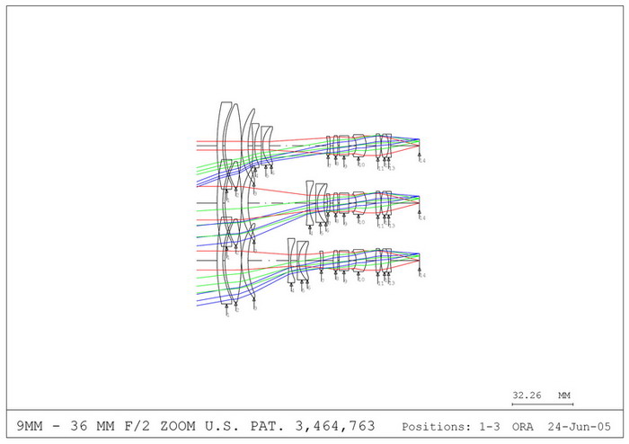

发表于 2005-6-24 23:00:00 | 显示全部楼层
vie;
ssi ((oal s1..i)/10)*(num z);
ofs ove si;ret za yes;ret zL no;
ofs z1 dim si 0 30;
ofs z2 dim si 0 -30;
nbr ele ;
!lns s7..11 blu ;
!lns s12..13 gre;
go;
发表于 2005-6-24 23:07:00 | 显示全部楼层
