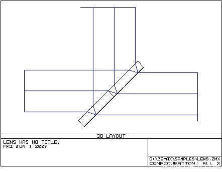

zemax里面设置半反半透镜
发表于 2007-6-1 11:42:56 | 显示全部楼层 |阅读模式
Surf     Type         Radius           Thickness                Glass       Diameter          tilt abot X
OBJ STANDARD       Infinity       Infinity                                  0                  0
STO STANDARD       Infinity            100                                 50                   0
   2 COORDBRK              -              0                                                          45
   3 STANDARD       Infinity             10                    K9            100              0
   4 STANDARD       Infinity            -10                  MIRROR           100              0
   5 STANDARD       Infinity              0                    K9            1 00              0
   6 STANDARD       Infinity              0                                    100              0
   7 COORDBRK              -            -100                                    -              45
  1 Thickness   1 :           100
  2 Param 3     7 :            45
  3 Thickness   4 :           -10
  4 Thickness   7 :          -100
  5 Glass       4 :                 MIRROR
  6 Glass       3 :                     K9
  7 Glass       5 :                     K9
Configuration   2:
  1 Thickness   1 :           100
  2 Param 3     7 :           -45
  3 Thickness   4 :             0
  4 Thickness   7 :           100
  5 Glass       4 :
  6 Glass       3 :                     K9
  7 Glass       5 :
