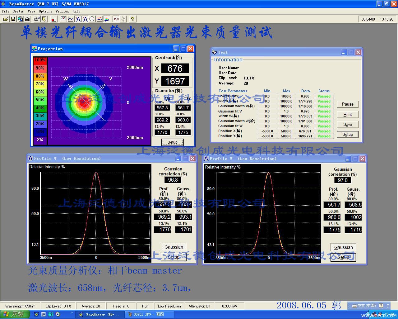

hi there
what method do you use? slit or camera?
发表于 2008-6-7 23:34:49 | 显示全部楼层
how much power  was your outcoupling?
 楼主| 发表于 2008-6-8 12:11:04 | 显示全部楼层
原帖由 Victorzhao 于 2008-6-6 18:15 发表
CCD camera/Coherent Beam Master
 楼主| 发表于 2008-6-8 12:21:30 | 显示全部楼层
回复 #3 天天好心情 的帖子
The coupling efficiency is from 50% to 80% in accordance with different types of laser diodes.

发表于 2008-6-10 18:47:30 | 显示全部楼层
fiber type
what model of fiber do you use? who is the vendor?
 楼主| 发表于 2008-6-14 21:25:54 | 显示全部楼层
原帖由 Victorzhao 于 2008-6-10 18:47 发表
The vendor is Fibertech from Germany, we also are the distributor for their fiber products in China.
This type of single mode fiber is with 3.7um corediameter and 0.12NA, thanks for your attention.
