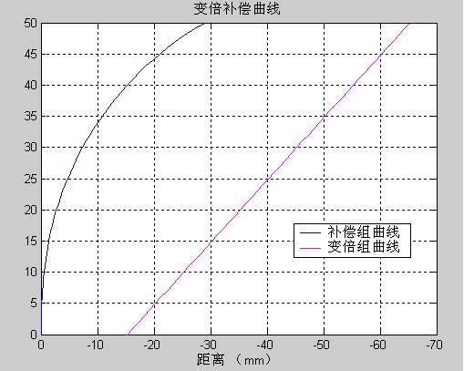

发表于 2008-7-14 15:14:03 | 显示全部楼层
有很多做法,看你的数学水平如何了.
我做的曲线是如下形式:当然每条曲线都有一组参数对应了.
y=a+bx+cx^2+dx^3...
a =        -4.4190254E+01
b =        2.1101531E+01
c =        -3.3984299E+00
d =        3.4512478E-01
e =        -2.2501970E-02
f =        9.5231127E-04
g =        -2.5948151E-05
h =        4.3815725E-07
i =        -4.1639139E-09
j =        1.6999125E-11
